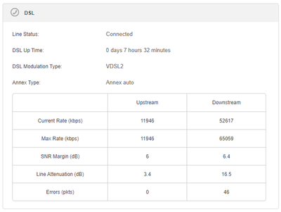

on 14-06-2022 11:12 AM
Message 13 of 21
With all due respect, I have done this many times over the last nine months. Have replaced a router and kept in connected for weeks. download speed has gradually decreased from high 50's to what it is now so I have no reason to believe anything is going to change today.
Its been over three hours since I changed the microfilter, cable and router this morning for you. below is the DSL status and as you can see, speeds are the same but the SNR margin has increased.

Message 15 of 21
Have done both now:
DSL screen on the TP-link shows:
Show option menu
