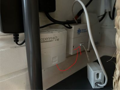

Ok I followed this instruction https://community.talktalk.co.uk/t5/Articles/Your-guide-to-main-phone-sockets/ta-p/2205432#test%20so...
and it's in there now:
on 08-02-2024 12:16 PM
Hi Frock
Thanks for your reply.
On the Openreach socket, there should be 2 smalls clips on either side, if you squeeze the 2 clips then the bottom half of the socket should come away to reveal a test socket.
Could you connect the filter and router to this test socket?
on 08-02-2024 12:12 PM
I've move the Cable from the open reach BT box to the other one. Is this what you meant? Internet isn't working anymore
