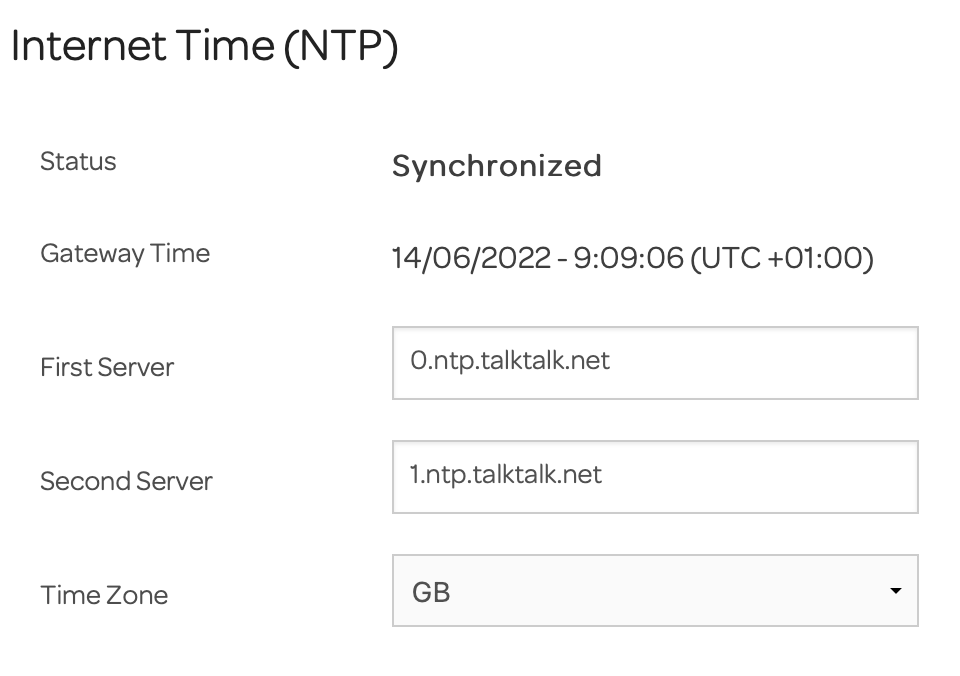

Hi SUPPORT,
While I was looking into the log to see what happen to the Internet. I noticed the TalkTalk Wi-Fi Hub 2 NTP is not able to sync time correctly. I have try change the NTP server to google is not working either, I can confirm by pinging the google and your talktalk NTP servers both are able to ping. but your router is not functioning properly.

on 14-06-2022 09:11 AM
fantastic. NTP is working now.
on 14-06-2022 08:04 AM
Morning,
Our team have advised that this should now be working. Would you mind retesting please.

13-06-2022 10:58 AM - edited 13-06-2022 11:00 AM
Hi Keith, the original NTP setting wasn't able to sync the time that's why I changed the NTP server. I did a ping on the NTP server they are fine. I also factory reset the router too. None of these help

on 13-06-2022 10:22 AM
I do not have the hub 2, but I have never had an issue in respect of NTP with the first Sagemcom, set as default like this:-
What happens if you use these NTP servers?
If it still does not work, and neither does a factory default, then I will draw this to the attention of the TalkTalk products team.
