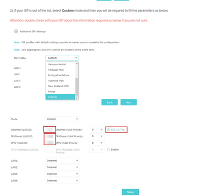

I am trying to connect my Archer router and am having problems. Existing connection working with talk talk  router.
Seems I can't get an IP issued to the router . Have done a factory reset on router and noted the settings required by talk talk for 3rd party router.
VLAN ID :101
MTU: 1500
DND: Automatic
Authentication: DHCP/IPoE
When I go to the settings in the router there are other VLAN ID settings which are set to zero ,and the router requires some value other than zero.
Is there something that talktalk need to do their side to allow the router to work ?
So I am wondering if this is the problem.
Any help appreciated.

Thank you Debbie for your help. The changes you have made have worked straight away. My TP-LINk router connected and i'm on it now.

Thank you. I've made the change to the profile, this can take up to 30 minutes (max) to connect.
If it hasn't reconnected by 12:45 then try a reboot of the ONT and router.

No changes are needed on your side, just on ours.

Please can you connect up the other router (non TT) at 11.45? I can then check the profile and make the necessary changes. Just to add, once we change the profile then the TT router may no longer connect.
