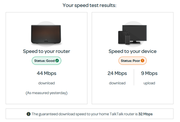

24-06-2024 02:37 PM - edited 24-06-2024 02:37 PM
Message 15 of 142
Heya,
Our speed is now below our guaranteed download speed (not that I know what that really means). Interestingly the speed checker says we were getting 44mbps yesterday, it seems to have been on a downward trend lately around mid 30s.
The above was done using a Cat6 wired device directly into the router.
Router is showing the below
Many thanks,
Rob_B
