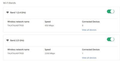

My older devices which use 2.4Ghz wifi can no longer connect to my wifi. Devices using 5Ghz connect with no issues.
After logging into the HUB I can see that both 2.4 and 5GHz networks are enabled but when I try to connect with my older phone I just get a message on the phone 'connection failed' I tried with a few different older devices with the same result - they cannot connect.
