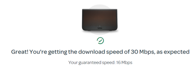

When I extended my contract last year I received an email quoting a Minimum Guaranteed Speed of 72mbps. I obtain that speed for a while after an Openreach engineer has been to check the line to my home. Then over a period of time the speed reduces to around 60mbps and later still to around 50 mbps. This past week my speed as been struggling to reach 30mbps.

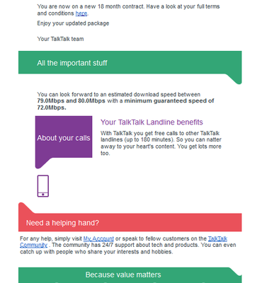

This is a snip of the email showing a minimum guaranteed speed of 72mbps.
Actual speed test result on Talk Talk website.

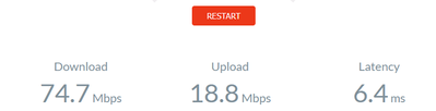

And results from Speedtest which shows a high Upload speed in comparison to the download speed.
I reported the problem but came up against the fact that I was getting speeds higher than 16mbps so I don't know if anyone is bothering to look into it.  Is my speed capped??

**Our website states that the customer will have a minimum guaranteed download speed of 41mbps.
**The customer also received an email from us, which was sent to myself, confirming she'd have a minimum guaranteed download speed of 72mbps.
This was the email I received when I extended my contract on 05 April 2022. Nobody at Talk Talk believed me when I quoted this GMS. I accept it is unreasonable to expect a speed higher than Fibre65 just as it's unreasonable to accept a GMS of 16mbps.

The estimated speeds are provided by Openreach initially and are a generalisation across the area with the guaranteed minimum throuput speed set just below the bottom estimate. These are set on your account but can often change and be revised by openreach based on changes to the infrastructure in the area.
Looking at our network system, I'm showing that the sync speed is 79mb. The bottom estimate for sync speed is 72mb, and throughput estimates are lowest download 18.5mb with guaranteed at 16.6mb, this being the 10th percentile.

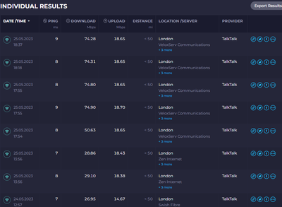

It did not matter which speed test I used the connection from the fibre was bad. I also used the Talk Talk one but like to use Ookla because it gives me a record, yours does not.
Please look at the results this evening and tell my why the Guaranteed Minimum Speed is so low at 16mbps.

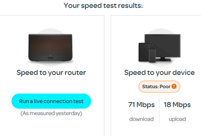

Why can't I get a reply from anyone at TT on the very low Guaranteed Minimum  Speed when my connection gets very good speeds when it's working correctly. Is Talk Talk trying to weasel out of it's obligation to customers.  One Customer Service Assistant told me 'but your getting more than the guaranteed speed of 16mbps' . It wasn't until I spoke to another assistant and carried out a router reset (pin hole) that I was taken seriously.
The Openreach engineer arrived earlier today and it was working again, at over 70mbps, as soon as I tested it.  The engineer didn't need to access my home and must have resolved the issue at the fibre cabinet  just outside.
You can see from the test results that my connection is working well again. Nothing was wrong with my devices or Ethernet/no Ethernet.

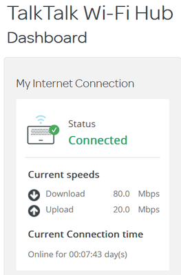

And the Router Dashboard speed test. This must show how ridiculous the 16mbps Minimum Guaranteed Speed is and supports the speed quoted by Openreach Engineers of between 70 and 80mbps.
