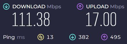

Since all these fixes. My speed has gone from this...
4th March 2024
To This...
Today 12th March 2024
I'm beginning to wish I'd just stayed as I was.
I ether need to be put on channel 44 and stay there. Or the FIX needs to be taken OFF. In the hope that my router will sort itself out.
This is the most silly situation I've ever been in. All because erro's don't let you pick your own channel.
Thanks In Advance!

Thanks Michelle,
Speed is really down today.
This is the worst one I've had since getting Full Fibre 150.
At least when I was on channel 149 my speed was good. 148 up 31 Down. It was just that some devices were stuck with an extremely congested 2.4ghz, because they couldn't see the 5ghz channel the 149.
I think I've had about 3 Fix's so far. Each one either not lasting 24 hours. Or like now making things worse.
Not sure if my speeds are so bad just because I'm on such a congested channel. But I am starting to worry!
When one of the fixes put me on channel 44 I was so happy. But it only lasted until I found myself on 153 the next morning.
I just wish I could be put back on channel 44 and stay there. Otherwise... Even 149 was better than this.
My speed seems to be getting worse with every fix applied. And that really is worrying!

07-03-2024 04:19 PM - edited 07-03-2024 04:20 PM
Hi Chris,
I'm connected Ok. It's just that my speed is all over the place now that I'm on channel 36 along with the rest of the neighborhood.
This Morning!
Little Later...
Happy!
But In The Last Hour...
I'm just hoping things will settle down!
It's like a game. Talk Talk pops me off one channel and then we see what new channel I land on.
If I had landed back on Channel 44 like yesterday. things would have been fine. And I'm starting to worry that every time the fix is applied it upsets my speeds. Or maybe it's just because I'm on such a congested channel. That is why I'd like to know if my erro 6 will still be able to move itself to a better channel. ( Only Lower Numbers 40, 44, 48 Obviously! ) Don't want to be worrying about being on channel 36. If there is a good chance I'll wake up in the morning to find myself back on my favourite channel 44.
Obviously I don't want to end up back on the high ( 149 or 153 ) numbers either.
Thanks!
