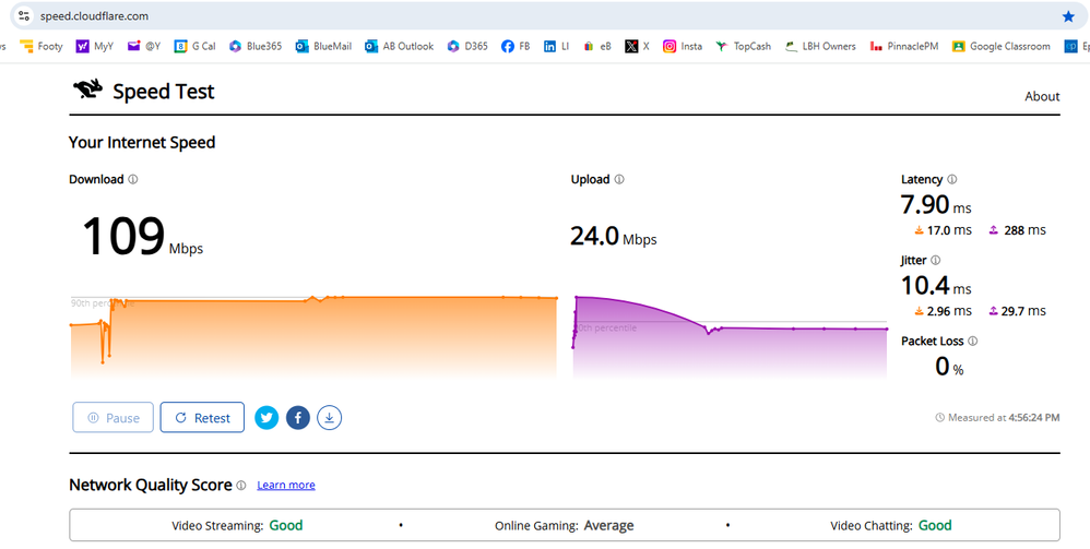

@KeithFrench I have conducted more analysis.
I have conducted a speed test at the ONT...by plugging my PC into the ONT via a Cat5e cable and running a speed test.
Wow - The ONT is getting 109Mbps down and 24Mbps up. See picture. Virtually exactly the same as the eero.
So - the speed issue is NOTHING to do with the eero or my set up in the house. It is completely to do with either the ONT (see pictures) I think it is a Huawei 1-port or with the exchange/cabling outside. CLEARLY this proves that I am not going totally mad and that some technical person needs to act and get my Fast Fibre 150 working properly at the exchange or from exchange to my house. All of this absolute tosh about needing a second eero and trying to upsell me makes my blood boil.
Can this somehow reach the powers at TT for action??
Yours in hope, Darrell

Thanks for the ideas Keith.
I have now turned off the ONT for 30min and restarted.
Changed the cable to a brand new Cat5e one.
Connected it all back up and tested via the eero app...no change. Still 108Mbps down and 23Mbps up.
What next?
Darrell

Hi @Powderhound
Yes you are probably correct about the sales info, but that is beyond my influence I am afraid.
With the eero app only shows 108M, that is a problem with the Full Fibre network or your Ethernet cable between the eero & the ONT. Have you tried turning the ONT off for a full 30 mins & testing again?
Keith
