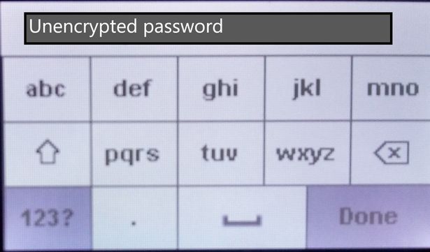

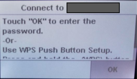

Not knowing the exact HP printer that you have, but there should be another way, nothing to do with WPS. I used to have an HP Envy and on that, you could do a manual setup. Here the printer tells you which WiFi networks it can detect, you select your one, and enter your password manually. It does probably involve using some special key sequences to be able to enter the password, but your printer manual should tell you how to do this.
This is how I had to do it on my printer:-
Initially connect the printer to the Wi-Fi network. To do this, on the Printer Control Panel:-
  1. Touch the Wireless icon
  2. Touch the setup icon
  3. Touch Wireless Setup Wizard
The detected SSIDs are shown below, touch the required one:-
WiFi network listWiFi network list
Touch OK in the next screen:-
Touch OKTouch OK
Enter the password with each key working like the letters on a mobile. The unencrypted password can be seen at the top of the screen, as you enter each character below:-
PasswordPassword
When OK touch Done & the password confirmation screen is displayed. Click OK on that screen.
