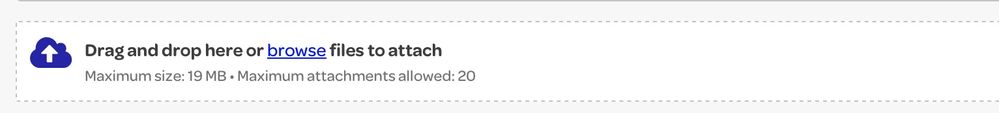

So are you using drag and drop to add the files or browsing to the files.
when you reply, under the text window is the option to upload files either by drag and droppping the images over your question or browsing to the files you have saved from screenshots.
on 17-09-2023 04:36 PM
I've done all the screenshots from a Windows 10 laptop, but I can't get them to upload to this message board😫. When I press on 'Done' or 'Upload' nothing happens...any ideas? So sorry
