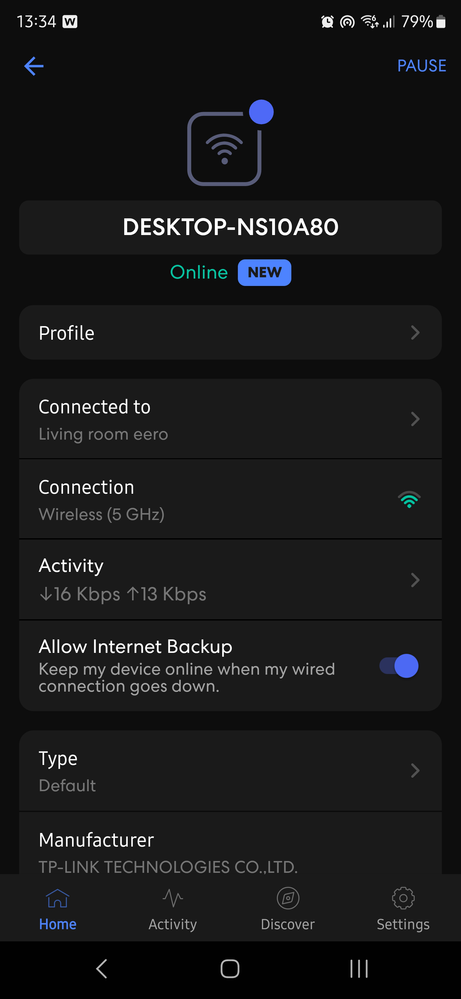

Thank you. The PC does seem to be doing better today which is weird. Still not getting the full 150mbps and it is a bit up and down but it is better today. I tried setting the dongle to only run on a/n/ac and tried a usb2.0 port instead of 3.0 but the only change is it seemed slightly slower in the 2.0 port. I can see on the PC it is only wifi5 too so not sure how much difference that makes for speed.
Here's the screenshots you asked for.

Hi @Chopkins117
@Michelle-TalkTalk has asked me to help you.
Yes, your TP-Link range extender is likely to cause issues, but first I want to address the problem of your PC.
If you use the eero app, find the PC in the initial device listing, tap on it & see which WiFi band it is connected to.
Then I need to see the Radio analytics screen for the 5GHz band. To find this in the app:-
1. Tap the appropriate eero mesh node.
2. Then tap on that eero’s Wi-Fi Radio analytics page.
3. Tap on the appropriate 5GHz Wi-Fi band and the channel number etc is displayed near the bottom of the page. You may have to scroll down the screen to see all of this.
