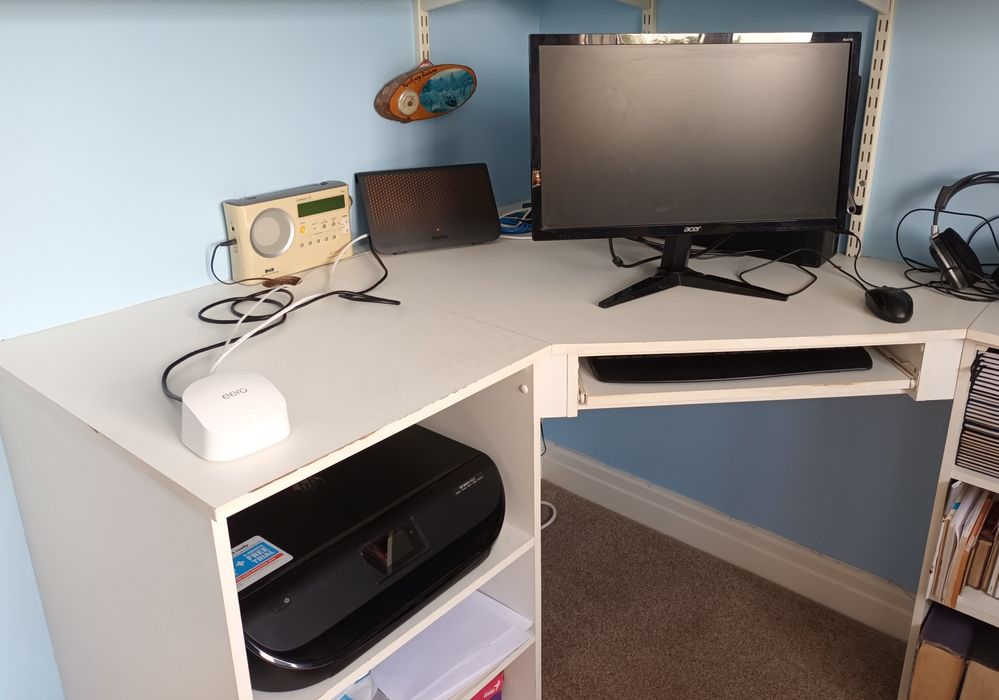

I have repositioned the Eero as much as possible, bearing in mind the amount of cable I have to work with. I will advise though that the previous router was in a similar sort of position.
The old TalkTalk hub is actually switched on and the red light flashes on and off all the time; the second I took the photo it was clearly not displaying red.
The ONT is in the bedroom underneath the unit as displayed in the photo.
Please let me know if you think this arrangement will improve matters; I suppose time will tell.
Dave
Revised position of Eero.Revised position of Eero.Beneath the desk.Beneath the desk.
Message 10 of 17
On first impressions from the image you have posted. Your Eero is in the worst possible place.
It is sat on top of a PC and under a shelf against a wall. This will severely impact the Wi-Fi performance.
Having an Eero above you i.e. upstairs whilst trying to connect downstairs is also not a good idea especially with the metal of the PC its stood on acting as a shield. Eero Wi-Fi pattern is along the plane it is stood on and upwards. There is no way you will get a decent signal downstairs from this location.

I doubt adding another Eero node downstairs will improve matters much because it will not mesh very well with the unit upstairs given its location.

Thanks for your reply. I have just the one eero, as per the photo attached. As mentioned previously various other items not working.Eero placed on top of computerEero placed on top of computerThe message I get on the TV screenThe message I get on the TV screeno.
