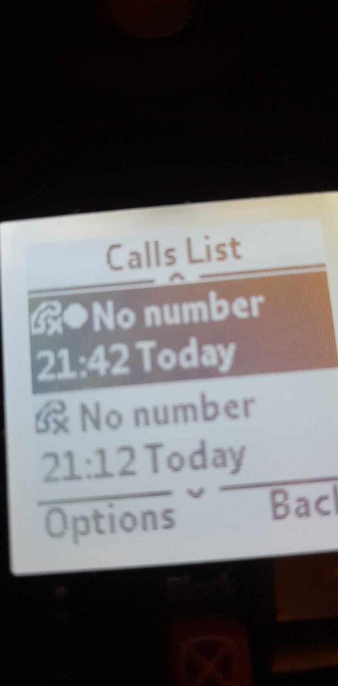

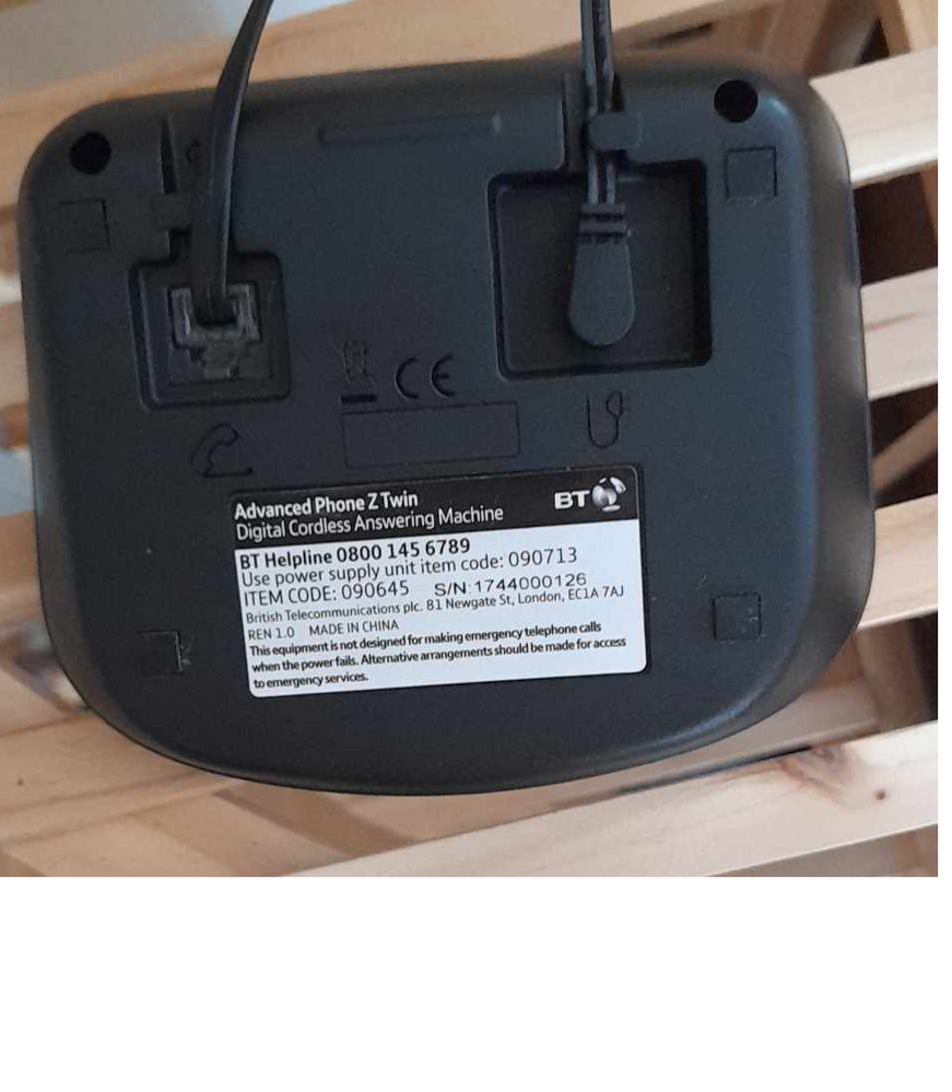

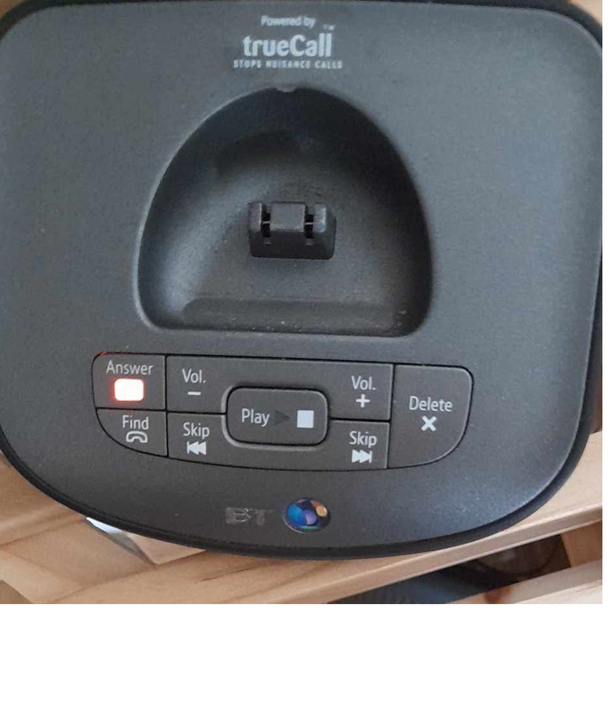

Hi All
Since upgrading to FTTP and plugging in my BT Advanced Z twin phone into a brand new Wifi Hub2 phone port with a filter, my phone registers a missed call approx every 30minutes throughout the day!! It doesnt ring but it lights up the phone.
I have seen Virgin had this issue and rolled out a fix, and another person in this forum has same issue also!.
Is talktalk aware of this? and any help will be appreciated.
See pictures for the message it shows on my landline phone and the images of the phone itself
