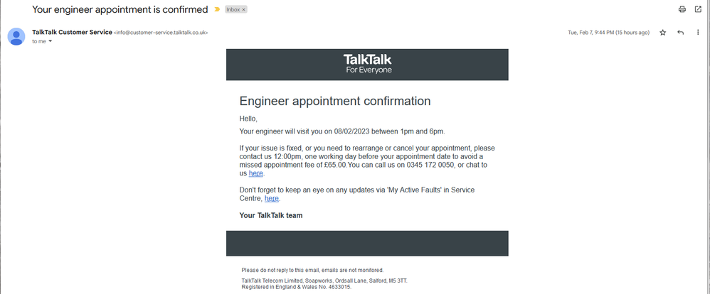

While I have booked an engineer through the fault tracker yesterday, I have yet to have any confirmation regarding the visit (or even a confirmation that the request has been made) via emails or text messages, and we've now entered into the 24 hours within my asked time slot. Are you able to confirm that the request has been successfully sent? Below are the screenshots from the web-age after completing the request.
Edit: Disregard, email confirmation arrived 21:xx the evening before appointment. Will post tomorrow to confirm outcome.
