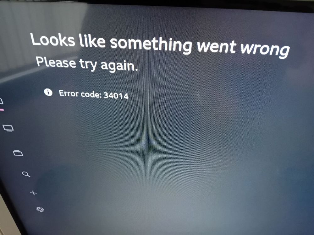

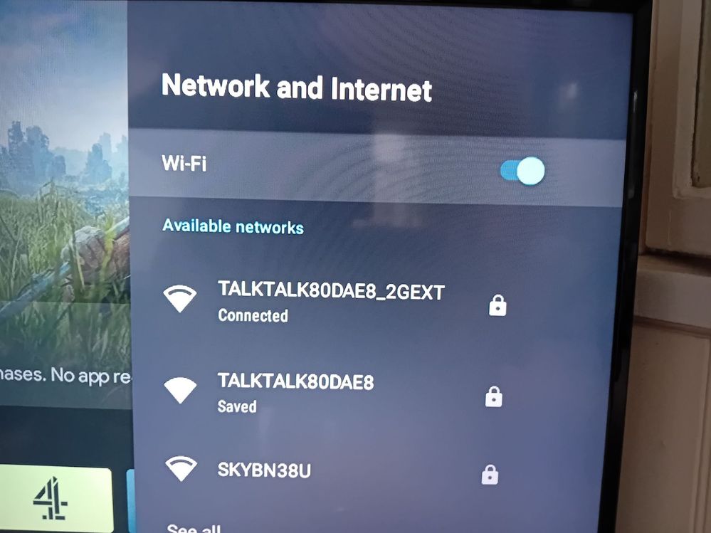

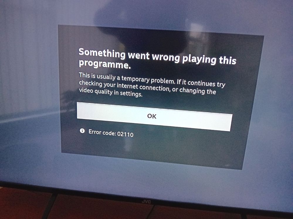

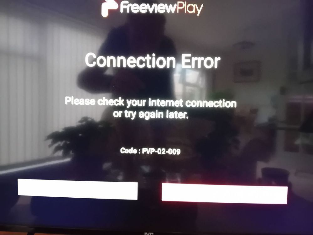

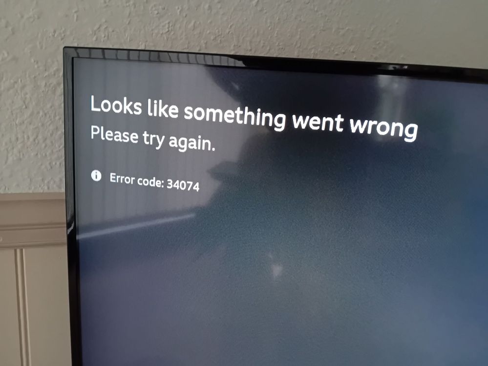

Result! After I sent the last message I switched back to the Turkish Detective and basically iPlayer locked up on me. I could not access Netflix either.
I then moved the TV to the router and it reacted the same with the direct ethernet connection.
I took photos of all the screens that appeared.
I hope this gives some insight into the problem.
