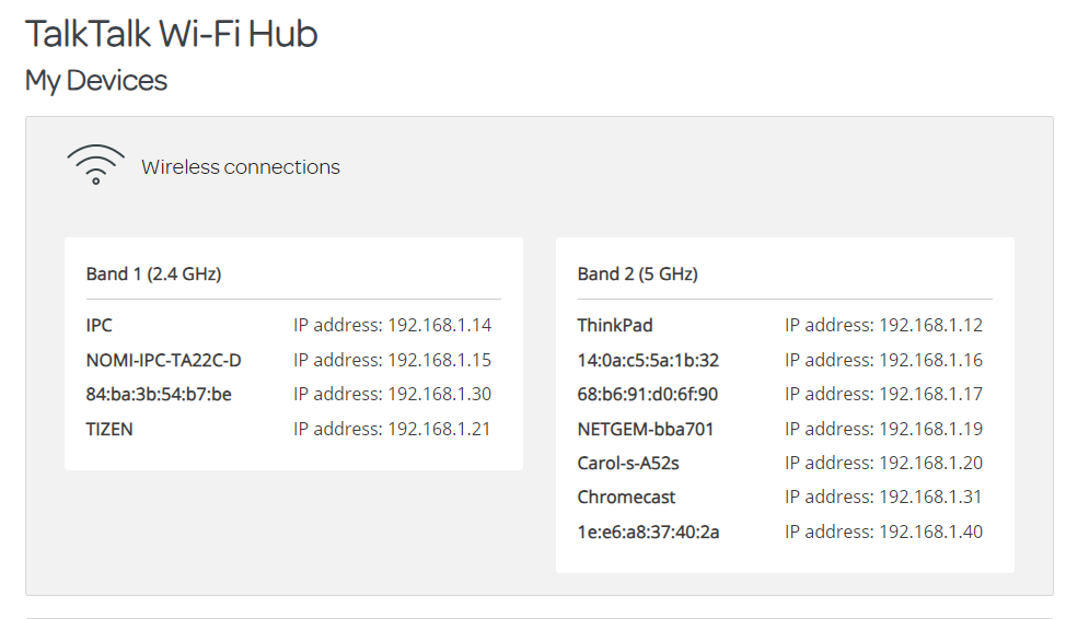

I'll take your word for it, as I have no idea which of those devices is your TV. You can customise their names to make them more user-friendly if you wish.
Wi-Fi interference is very changeable, by the minute or even second. You would need to set the adapter to at least prefer the 5G band, but I bet the TV does not have that option.
Message 2 of 19
Seems it is compatible and connected via 5GHz.

First off, is it even 5GHz compatible?

If it is interference/congestion that is causing me problems and the 5GHz band is 'less congested' then does my 4K box have the capability to connect to the route via the 5GHz band? If so how would I do that?

If your TV connects to the 5GHz band, there should be no particular problems (assuming these screenshots were taken near the TV). However, if it only connects on the 2.4GHz band, that is a different matter. Your 2.4GHz band is totally congested and there is nothing you can do about it, other than considering a wired (Ethernet) connection. This could be achieved with a pair of Ethernet power line extenders if the router & TV are on the same electrical ring circuit.
