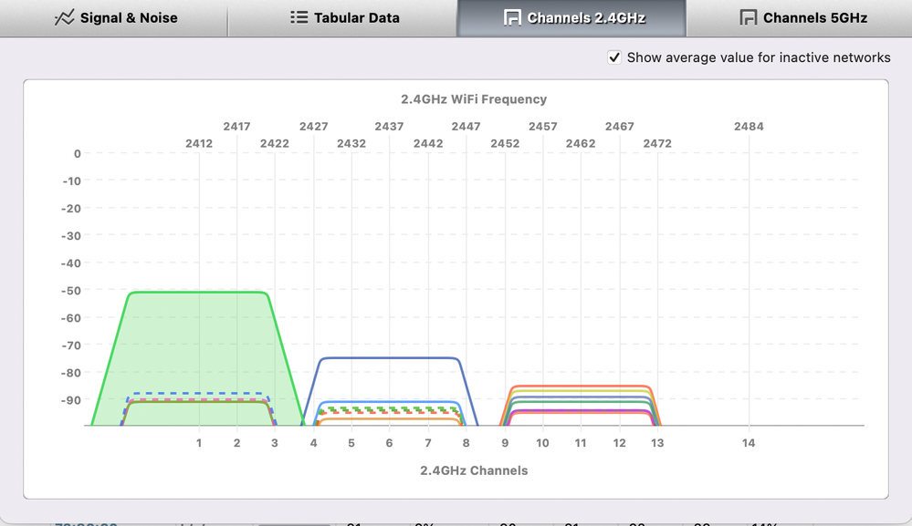

@KeithFrench Great advice and help as always. A bit like this?
KeithFrench
Message 16 of 28
Thanks for your screenshots, things are much worse because you are now using a channel bandwidth of 40MHz in the 2.4GHz band. This is also not recommended, because it uses 9 out of 11 channels and will at best slow your throughput. You will find it much better using 20MHz Only. How to change this is documented in my guide.

Hi @KeithFrench  sending screen shots channel 1.
A question for you , using Netspot, I've noticed from nearby APs that all are using only channels 1,6 and 11 in the 2.4k band. I assume that their routers etc are in auto channel switching, if this is the case why doesn't my hg635 do the same when in auto.

ok @KeithFrench  thanks for the advice .
Have changed to channel 1, lets see how that goes.
KeithFrench
Message 20 of 28
Hi @ernie66
The problem is not your router, I see no need for @Debbie-TalkTalk to replace it at all, but that is out of my control.
You are currently using channel 4 in the 2.4GHz band, which is interfering with everyone else on channels 1 & 6 and hence they are interfering with you because of this.
Please note that you can only use channels 1, 6 or 11 in the 2.4GHz band, as they are classed as the only non-interfering channels. However, I have seen a lot of cases of recent, where people do not follow this recommendation, which is probably down to they did not know about it!
What you need to do is move your router to channel 1 (see my guide if you do not know how to do this). Then if you still get problems after that, please PM me another set of screenshots. If you do, it would help if you highlight your network in the AP view, rather than the Linksys one that you have done.
