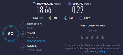

The reason I'm altering these settings is to try and establish what keeps bringing my speed down.  After weeks and weeks of messing about, two engineer visits, new router and countless hours, I'm back to 11 DOWN and 0.5 UP.  For a little while I was getting 30 D and 7 UP which was fine, But there seems to be something about my home set-up the DLM doesn't like, I think.

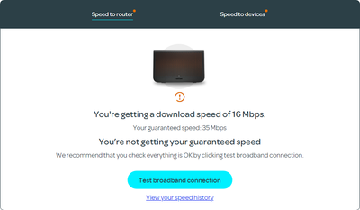

The result of the line test is that my "broadband connection looks like it's working as it should be"  (text mssg).  Really?  How?
When your own screen says I'm getting 16 to the router, how is that "working as it should be"?  This is an genuine question, I'd really love to know how this works.

 A per usual, my speeds went up before the engineer arrived, I'm guessing something has been tweaked. 27 download and 3 upload
When he came he said he'd "reset my profile and that it would take a couple of days to settle down".
He's tested the line and said that it was good.  As the weather is fine today, this doesn't surprise me much, I'd like to see him do the same tests with water on the wire!  It's still touching the neighbours roof, that can't be good. He says it wouldn't make a difference and that his test would show if the insulation has broken down. As an ex-physics tech, I have my doubts on this
He's now gone to the green cabinet to check that and will be back soon.
My current speeds are 3 down and 6 up, perhaps due to the tinkering going on at the moment.  (this is 12.20)
