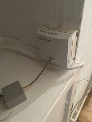

Here’s a picture of my socket. I come back home and I had connection for like 50mins and then dropped down.

Hi @nikola77
Thank you. I can then check if your master socket has a test socket. It's always worth testing the router at the test socket to rule out any internal wiring or faceplates faults before progressing to an engineer visit.

Hi @nikola77
Would it be possible to post a photo of the socket and how your router is connected on this thread please?
Thursday
If the test socket is the white one I have next to my router then yes it’s connected @Debbie-TalkTalk
