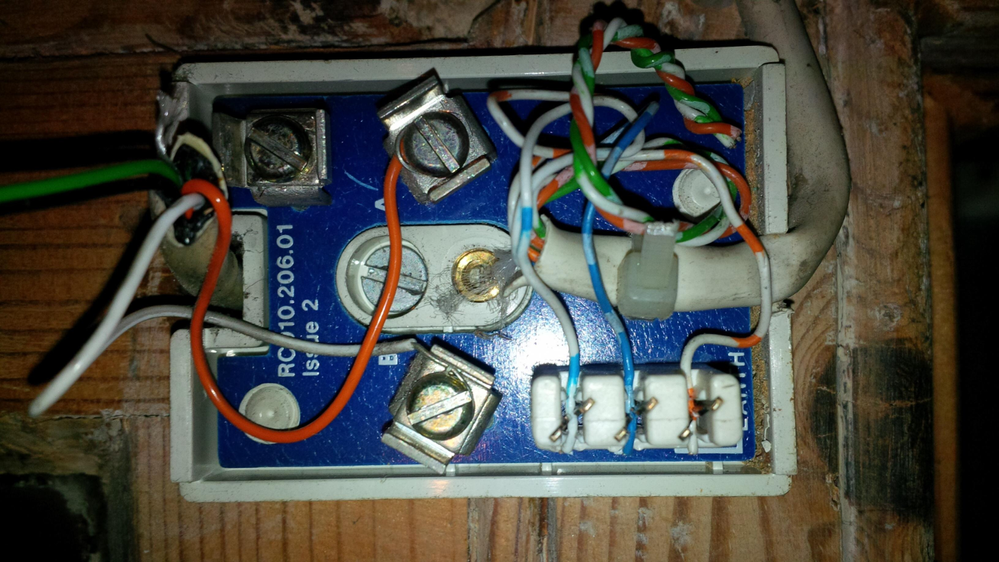

BT80 Conn. BoxBT80 Conn. Box
As in the picture above, the orange and white wires connected to the screw-terminals A and B respectively (which form [albeit loosely] a twisted pair, believe it or not!) look similar to aluminium wires, but are actually tinned copper. I think that the use of aluminium wires ended some time before the orange-and-white pair were used.
Not all drop-wires have tinned copper conductors, I hasten to add; some are just bare copper.
