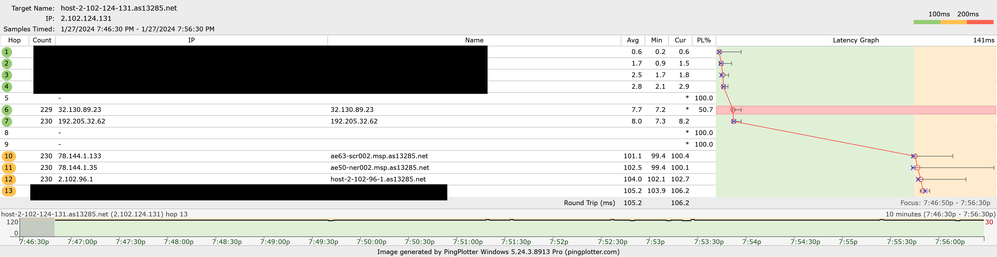

I have attached one of the test from outside my network back into it, at hop 9 the ping will randomly fluctuate to over 100ms from looking at my settings this is my WAN router IP address and where I think the fault lies

heres another picture showing the issue starts with the talktalk network

As one final check i have hard reset everthing again, turned everything off for 30+ mins and issue of latency is still there, I have ran another check connecting from outside my network back into it and again the issue is showing around the talktalk network external to my home, How do i get an engineer booked to look as this as all talktalk want me todo is reset stuff over and over again which is clearly never going to work is the system i connect to is at fault

Everything has been powered down and also reset/hard reset multiple times, I have connected to the ONT with my router that supports upto 10G SFP+ on its wan ports the problem is the same and in the same location 2.102.96.1

To clarify, the high latency issue is not isolated to the game server; it is occurring across any and all devices that are utilizing the connection. This rules out the possibility of it being a device-specific problem.
The key observation from the network diagnostic data (as shown in the latency graph) is that the latency remains within expected parameters from hops 1 to 8. However, at hop 9, which has the IP address 2.102.96.1, there is a substantial and consistent increase in latency. This particular hop is where my eero connects to as part of the WAN network, which is outside of my local network's scope.
Given that the latency starts to massively increase at this point and remains elevated beyond it, it suggests that the issue may be related to a hardware problem or a bottleneck at this specific juncture in the network infrastructure. The fact that this latency spike is consistent across various devices indicates a broader network issue that likely needs to be addressed by TalkTalk.
I would appreciate any further investigation you could initiate regarding the high latency starting from hop 9, as it seems to be a critical point affecting the service quality.

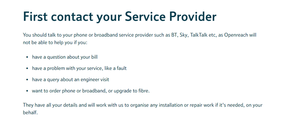

I was also given this email address and phone number to contact.
The email address is not valid and as per Openreach's website i should not contact them about a fault it is the duty of the provider to contact them
