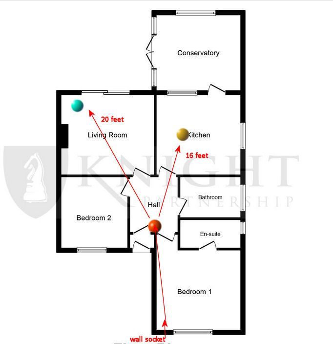

I tend to think that any modern router which struggles to send a signal 7 yards is an extremely poor one. The only obstacle in the way is a totally mechanical exercise bike. I even left all the internal doors wide open, which wouldn't be a good idea in winter. It is almost universally advised to keep the frequency at 2.4Gz, unless you have potential speeds way in excess of that provided here. My conclusion is that although the speed to the router may be a constant 150 megabits, that is pointless if the router isn't capable of distributing it.
p.s. Just for the hell of it I moved the bike out of the way. It made no difference in the kitchen and a speed of 41.6 in the living room. That's a slight improvent, but still way below what I was getting with my old router (and cheaper monthly fee) and inconclusive anyway, given the tendency for fluctuations.
Before I sent the old router back I tried to make a direct comparison, but found that the old router cable is incompatible with the new wall socket.

Sorry about the incomplete image. I tried to edit the post but couldn't find any way of doing it.Living Room PCLiving Room PC

These are the results taken this morning.
Holding my phone against the router I get Down 106.2  Up 28.6
Kitchen PC Wi-fi                Down 56.33    Up 29.18
Kitchen PC Ethernet        Down 144.18   Up 29.18
Living Room Ethernet     Down 135.18   Up 29.11
                         Repeated   Down 151.18    Up 29.11
Living Room Wi-fi            Down 18.48    Up 29.10
                         Repeated  Down   5.50    Up 29.10
                         Repeated  Down 18.48    Up 29.08
So the ethernet, although erratic, is acceptable, but the wi-fi performance is very poor compared to the one it replaced, which gave me a (mainly) consistent connection of 80 Mbps on a supposedly much inferior service. It would be a safety hazard to have long ethernet cables trailing across the floor of the house as well as being unsightly. I should add that at 6 metres from the router to one PC and 7 metres to the other (obviously on the same floor), this is less than the distance across many people's living rooms.
I have included the Speccy reports on the two PCs, hopefully without giving any senLiving Room PCLiving Room PCKitchen PCKitchen PCsitive information away. Please delete the images if so.

I felt sure that the operator described it as being a 180Mbps connection, but perhaps her accent made it unclear.
The problem is that it is extremely erratic. Measured just now it was a misery 54.6Mbps, although on other occasions it has sometimes reached 150Mbps.
I could only achieve acceptable speeds by drilling a gap into the bottom of an internal door, so that I could trail the wires under it to mount the router in a similar position to the previous one. I live in a semi-detached bungalow, but positioning it in the most safe and tidy position (about 10 feet further away than previously), had a drastic negative effect.
What I did discover was that there is something about the signal being broadcast by my new router which is incompatible with the network adapter on one of my PCs. Even with an ethernet cable I was still getting about 12Mbps, when my old router had been delivering up to 80Mbps. This doesn't seem logical, so I will repeat it tomorrow. A cable trailing over the floor permanently is out of the question. I subsequently improved on this by buying a usb wi-fi adapter, but customers are not warned about these problems.
