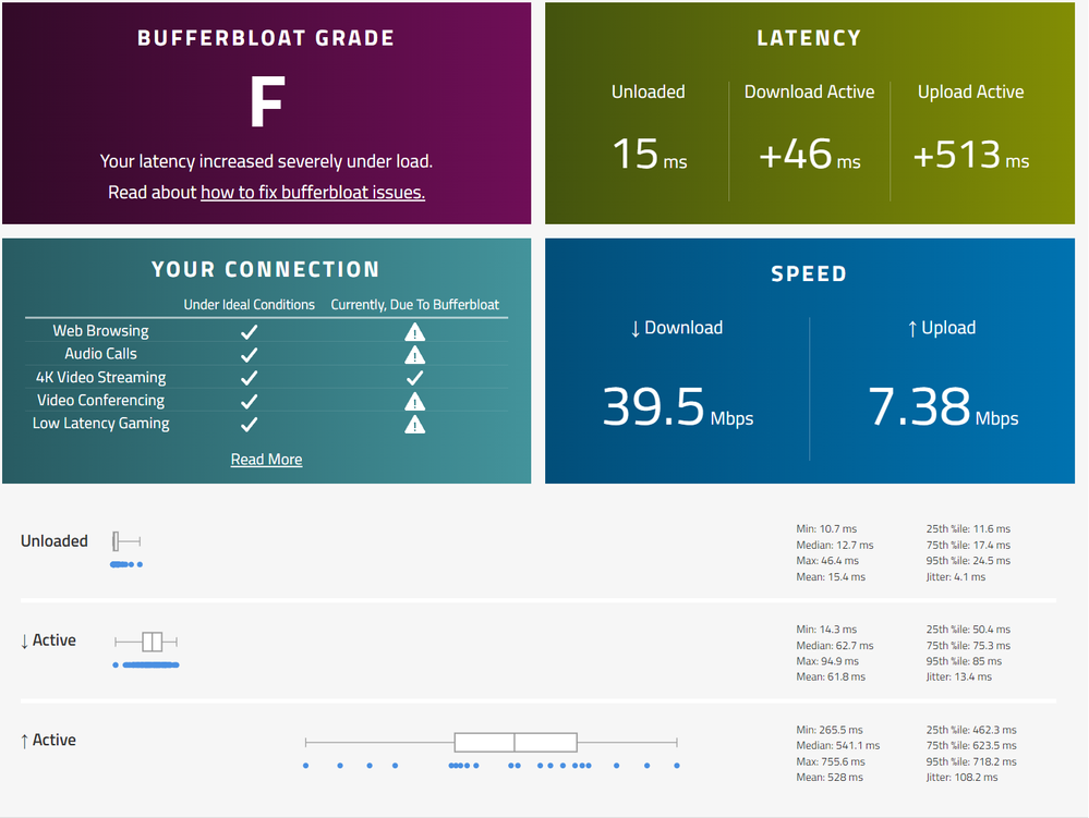

I gather from looking through the forum that this router cannot have passthrough/modem only mode enabled.
My question is, what modem would be suitable and would talktalk be able to supply one? I'm looking at buying a router with SQM so that I can hopefully manage the terrible issues I suffer when using more than 30% of my bandwidth.
Below are my results from the waveform bufferbloat test. It goes some way to showing why I have to have two DSL connections in my house because I having just the one it was always causing stuttering and lag and a lot of the time it would just freeze up and smart TVs when trying to watch a movie in high quality.

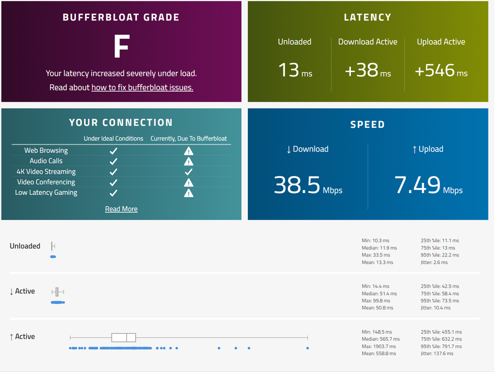

@KeithFrench I've run traceroutes to google servers and they come back fine, speedtest and bufferbloat tests come back ok on an unloaded connection, as soon as you start to use the bandwidth the latency goes crazy. I see a lot of people comment that it should and that the bufferbloat tests saturate your connection causing it to give high latency readings and I would fully expect that, however, even when I make a low quality video call and use half the upload bandwidth it has a dramatic effect on the quality of the connection.
@Chris-TalkTalk  I only have one telephone socket for this connection, the socket only serves the talktalk router. I have just completed a bufferbloat on the normal connection and on the test socket and there is no discernible difference between the two.

Your current sync speed is 41.8Mbps downstream and 7.9Mbps upstream. How many telephone sockets do you have? Have you tried connecting your router to your test socket?
