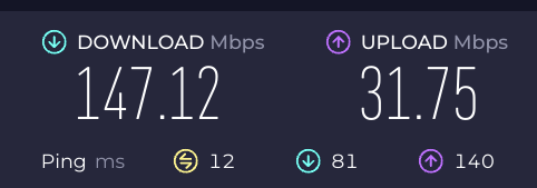

With no sign of the update to change channel for ourselves on the erro 6. Today I finally had time to set up the Hub 2.
Internet feels stronger and faster already.
First Speed Test...
