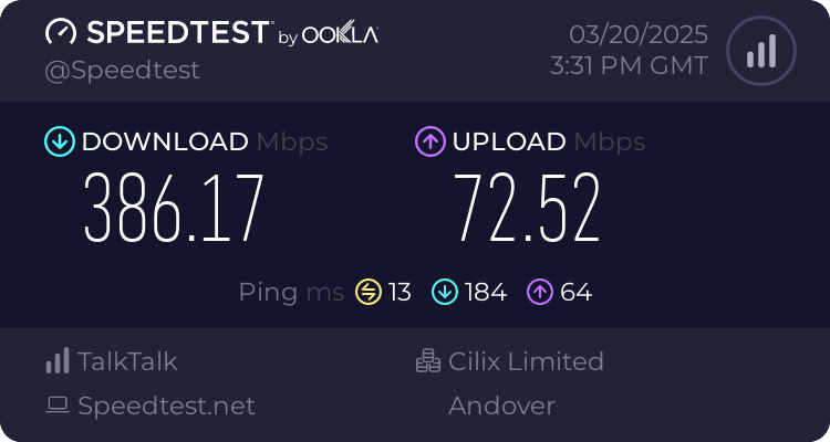

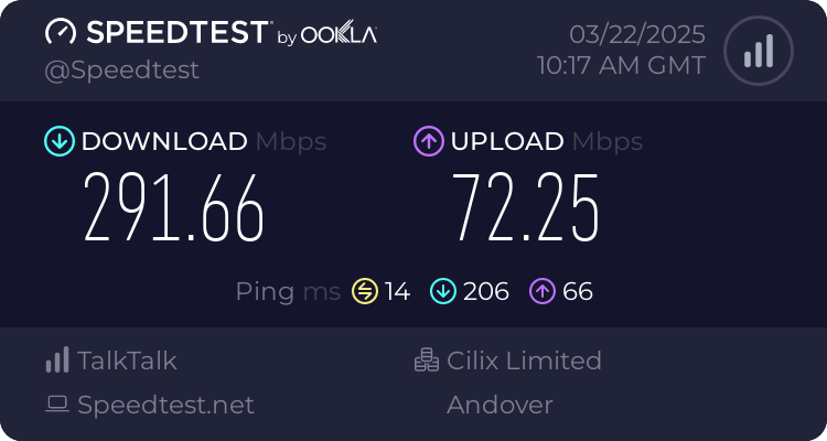

Was kinda busy yesterday and cable arrived late, but did testing today just now.
Made 2 tests, one with normal setup which was this one:
22-0322-03
And another one directly plugged to ONT:
ontont
So I'm starting to wonder that if my main eero is somehow capping my speed somewhere.

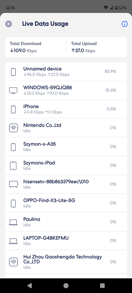

I have 3 devices barely taking anything from entire 500as you can see on eero app.
Today since 3rd of march for the first time test went that high.
Also I did re-contract my price and got sent another eero router, which I didn't want. So no idea what to do with it.
devicesdevices20-0320-03

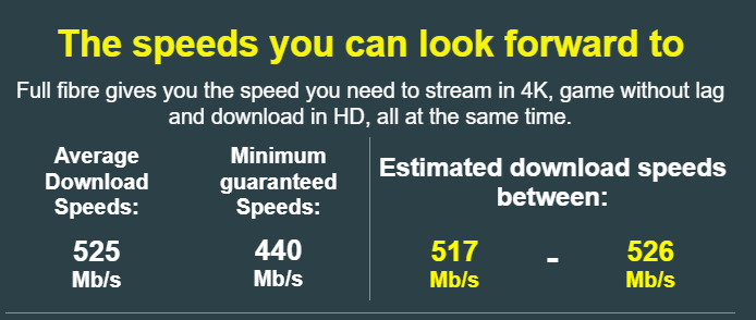

419 is not 440 last time I have checked.
minimumminimum
