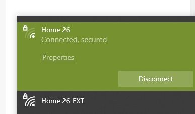

I have been doing diagnostics on the WiFi performance. This Eero is giving very poor coverage throughout the property and although there is some WiFi interference in the 2.4GHz band, the 5GHz signal is so weak it is non-existent in some parts. I feel that this customer needs an extra Eero node to have any chance of rectifying this issue, but what do you think?

Hi Ya
I've noticed that my Home 26 is 5gz and the EXT one is 2,4gz
My signal; for 5gz is Rubbish yet the 2.4gz signal is great
My desktop is in the room next to the router yet the signal is on 2 bars but when i switch the desktop to 2.4 the signal is 4 bars.whats going on and maybe this is the reason the Teams meeting last week kept freezing?
