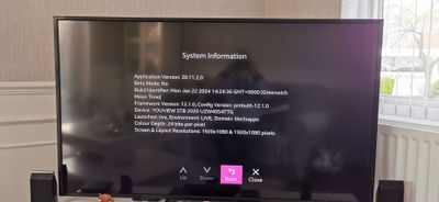

Hi,
So I tried again, via the HDMI 1 input on my monitor (V1. 4) and the max the monitor will go upto is 3840x2160 @30hz, (will go up to 4096x2160 but depends on the input signal) this should be fine apart from a slight judder due to the refresh rate, again I tried the display port (1.2 HRD or HDR2) which I achieve 3840x2160 @60hz, a smooth image and no judder, then I go to the iplayer and still will not see the UHD symbols?
factory reset the box and started again, checked for the latest iplayer update and running... See image...
So I'm at a loss with this box, it's either the monitor or some EDID handshake with the android box.
I tried a netgem 4k box and working okay.
all terminal settings been checked on the HDMI inputs and the Displayport and all okay, so i either need the Netgem box or........

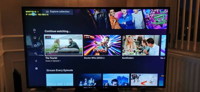

Hi
Just checked again on my box, the Tourist is showing in UHD.
Pick below, if you look at the tile for the Tourist, you can see it shows UHD in the top left corner of the tile.
Karl.

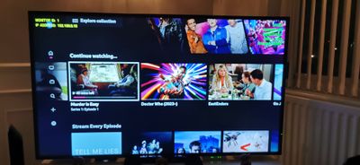

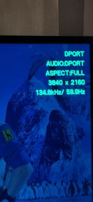

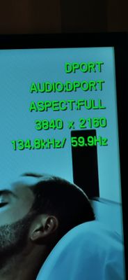

Hello yes I used the HDMI provided,
I am now linked to my monitor via the displayport which gives me 3840x2160 @60@60hz.
I have borrowed a netgem Talktalk box from my neighbour and that works fine, I have uhd symbols, but not with the android box.
1st 2 images are the netgem box, other 2 are android talktalk box.
