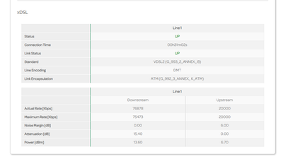

Let me try and explain further, I have added further information from the router/hub, that shows my xDSL line is connected,
but I have not been allocated a Public IP, repeated "DHCPC WAN DHCP client (1) failed" errors
From my first POST: 07.06.2022 03:30:46 Error DHCPC WAN DHCP client (1) failed
This issue started at 03:30 this morning Tuesday 7/6/2022, is there a know network issue?
Can the "DHCPC WAN DHCP client" issue be caused by the router ?
Router Log Info Below
xDSL
Line 1
Status UP
Connection Time 00h31m02s
Link Status UP
Standard VDSL2 (G_993_2_ANNEX_ B)
Line Encoding DMT
Link Encapsulation ATM (G_992_3_ANNEX_ K_ATM)
Line 1
Downstream Upstream
Actual Rate [Kbps] 76878 20000
Maximum Rate [Kbps] 75473 20000
Noise Margin [dB] 0.00 6.00
Attenuation [dB] 15.40 0.00
Power [dBm] 13.60 6.70
thanks
John
