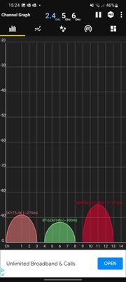

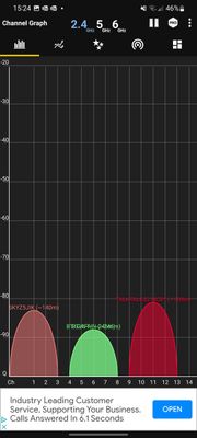

When approximately 10 metres from my router, the wifi analyser seems to suggest my router is over 100 metres away? And I keep losing wifi connection randomly

I have just been on live chat with talktalk and the representative tried to tell me that 0dB noise margin is better. I am glad you have backed up my understanding as I knew they weren't correct, although yes it does seem that the display is glitchy.
The wifi speed significantly drops off when I move about 10 metres from the router with no obstructions. They are now sending me a wifi booster, but surely something isn't quite right with the SNR?

Perhaps use a Wifi analyser app on your phone to see the signal strength and if there are any conflicts with another nearby access point.
