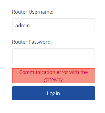

since around the 10th of December we have been having this issue where the internet drops out completely for all the devices in the household the light on the router stays a solid white as if nothing is wrong.
normally i would log in to the router page and restart it from there but each time i try it results in an "error communication gateway" message and does not log me in.
The only temporary fix i have found is completely disconnecting the router from the power and plugging it back in this will provide relief for anywhere from 30 minutes to a couple of hours before the issue happens again.

I'm trying to change the dns server as instructed but even though my internet is currently working it doesn't seem to want to allow me to log into my router page.
I have tried logging in on both a wired and wireless connection and with 2 different devices but I keep receiving the "communication error with the gateway" error message each time.
