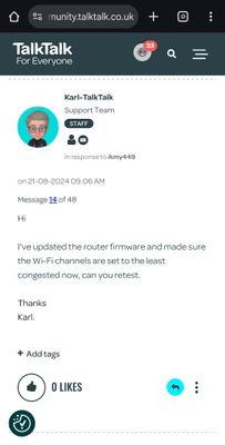

Please if there is anyone in the team that can action this as noted from 2024 I'd be grateful. I'll attach again now for clarity
Message 2 of 50
I appreciate all of this... but I went through all this before...it was not the devices. I blamed my phone for weeks last year and it wasn't anything to do with this. It's the fix that I've drawn attention to on this forum that Mark noted on 2024 from your team. I don't want to open up all the investigation into my devices again as I can't go through all that energy time investment when I know what's causing it. It just needs what I've asked re that message citing the fix. It's exactly the same.
I do really appreciate the effort to problem solve but it isn't any of my devices at fault or software or anything like that. I extensively investigated this previously.

I've updated the router firmware and made sure the Wi-Fi channels are set to the least congested now, can you retest.
Karl.
