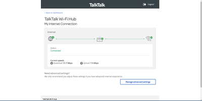

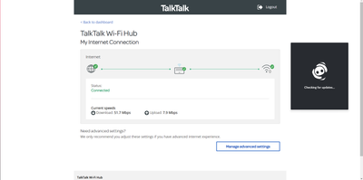

on 05-02-2024 07:37 AM
Message 6 of 33
Well it just dropped again and I waited a good 10 minutes for it to come back up, Router was saying it had dropped connection and was then connected again yet I couldn't get any devices online until I forced a reboot of the router via the admin page.
screenshots both showing the hub connection status and in the second screenshot is discord attempting to reconnect before I rebooted it.
after forcing a reboot everything connected ok, This leads me to believe the router is at fault rather than it being a connection issue.
Playing GT5 on the Nurburgring Nordschleife with my Chrome Enzo Ferrari 😉
