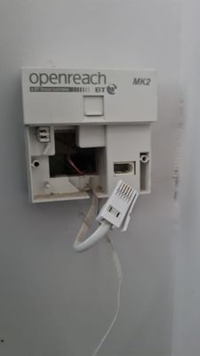

This socket should have a test socket underneath the face plate.
Could you remove the lower section of the face plate so we can run a line test with everything removed from the line including the face plate?

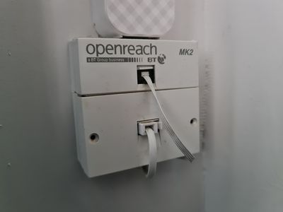

Would it be possible to post a photo of your master socket/set up on this thread?

I only have the main socket with two inputs. One input is connected to the stationary phone, while the other has a thin cable connected to the Openreach white box, which is then connected to the TalkTalk router.
This setup has been in place since 2017 and was working fine.

I'm sorry to hear this. I've run a test on the line now which has detected a loop fault (LOOP CONDITION DETECTED). Does your main socket have a test socket please? If it does then please can you connect the microfilter, router and phone directly at the test socket so we can re-run the line test again in this set up.
