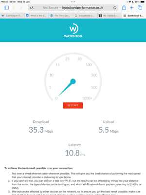

on 24-01-2024 09:22 AM
This is tested over Wi-Fi about 20 feet from the router.
Just now.
on 24-01-2024 09:12 AM
Hi
profile is currently set at 40/10, so this looks correct.
Upload speed estimate for the line is 7-8, can you run a speed test as Sam Knows Speedtest and tell me what this reports.
Karl.
