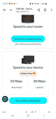

 just curso upgrade fibre 150 to 500.  I dud a speed test. I know it wifi to a mobile . I am sitting 1.5mtrs away from router.  Hiw can it say poor when it's near be much fast as openreach said
