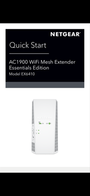

Hi @ang85
I don't expect that the Netgear is faulty at all, I suspect that its configuration is clashing in some way with the Sagemcom 5464. However, as I have no idea how either has been configured, this won't be easy.
First off though, I think that you said that the Netgear is configured in Access Point mode. Looking at the user guide for it, I assume that it connects to the 5464 via an Ethernet cable or powerline adapters, not via the 5464's Wi-Fi? If so, roughly where in your property are both of these units located & how are they connected together?
I did offer to send you a guide to you to help you get me some important diagnostic results so that I can analyse them for you and recommend changes to your router configuration to solve them.  Once I know the answers to my questions above, I will probably need to send this to you via a PM. Then I will need you to reconnect the Netgear for a short while, whilst I get you to gather the diagnostic information for me. Then it can be temporarily disconnected again.

Hi @ang85
Please can you give me a model number for this Netgear extender, then I should be able to answer this question?
Keith
Message 9 of 41
Hi there, just an update, once I moved the hifi speaker there was still an underlying issue and I’ve managed to track it down to a NETGEAR WiFi extender/access point we have connected to some equipment as an access point.
we tested this theory several times and that seems to be the issue with our WiFi disconnecting, so we’ve just disconnected it for now.
Any ideas why that would happen?
thank you
