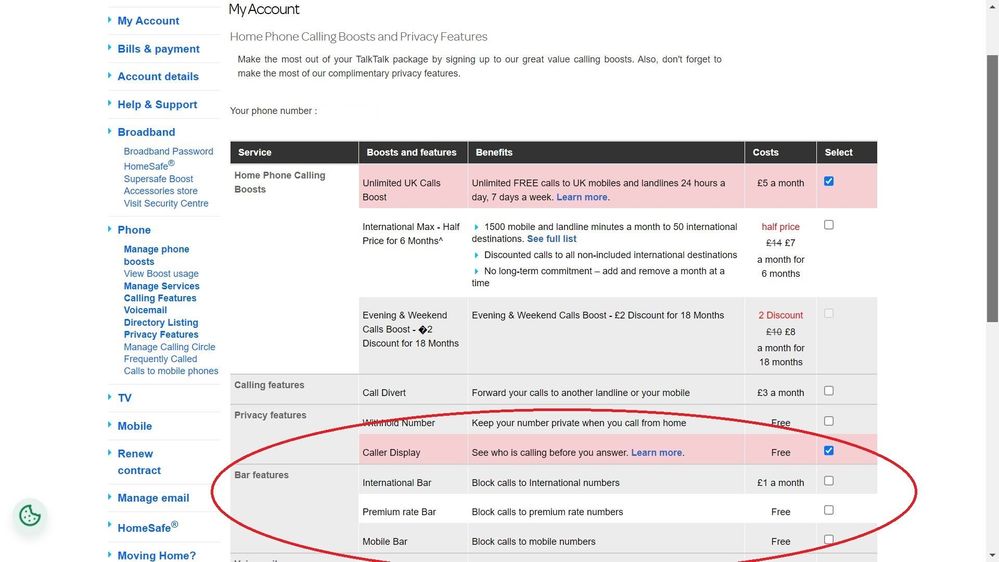

I understand that a system resync was subsequently performed at your end, however since then the problem with BT/EE/O2 users not being able to connect has gone from being an intermittent fault to a permanent one.  This is totally unacceptable and it is pointless to have a landline that does not accept calls from certain providers.  My wife and I both have elderly parents with whom it is important we keep in contact, as well as hospital appointments and other such arrangements it is imperative we manage by phone.  I can confirm that I have never activated call barring/blocking either on my TalkTalk account (see attached screenshots) or on the phone itself and have no other equipment at the property that could be causing this problem.  It is clearly a fault at your end and I must ask that you look into it as a matter of urgency; if it persists I will have no alternative but to switch providers.
TalkTalk account Boosts settingsTalkTalk account Boosts settings
Callsafe is OFFCallsafe is OFF
