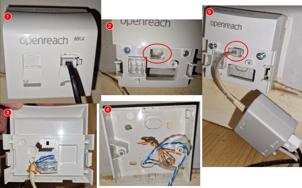

Hello,
This morning I started to experience random disconnections and reconnections. It often seems as frequent as every 3-5 minutes. For the short time that it's connected the speed etc is great, but then it disconnects and fairly swiftly reconnects itself automatically (I can still connect to router admin panel the whole time and observe that and I can see the internet connection uptime reset to 0). I am using the Sagemcom TalkTalk WiFi Hub but I also have an old "Super Router" so did try switching back to that for a little while so as to rule out a router issue but encountered the same problem.
I opened fault REP-13249974 which says it's in progress but got a text message which told me if I'm still having issues to chat to tech support. I did so but was asked some quite irrelevant troubleshooting questions and then he inexplicably blamed the ethernet card on my 3rd party smartphone device and said he's going to send me a new Ethernet cable, um...
Anyway not sure where I stand now on this fault? I've unplugged the router for a little while to see whether the connection stabilises at all when I plug it back in after a longer off-time. Appreciate any help/advice thanks.

Message 11 of 15
Hello,
Sorry I am a little confused because I only see one socket and it's the one I've circled in the screenshot I'm including, but that is the same socket that the face plate itself plugs into. Do you mean if I unscrew it as well? There is nothing else under there. I've numbered some photos in the attachment below to confirm, but my understanding is that although the faceplate plugs into the same socket, once the faceplate is off, that is what we call the test socket. Still monitoring it but I do think plugging it into there per photo (5) may have resolved the issue. Can you confirm I've done that right & run another test?
(1) is how it was before I touched it
(2) is what it looks like if I pull the face plate off
(3) is the underside of the face plate
(4) is what's underneath if I unscrew it
(5) is how I've left it now - is this what you intended? the only way I could see to plug the router in directly there is by adding the DSL filter.
Edit: I do have a dial tone and an internet connection uptime of 46 minutes so far since plugging it in this way (says it's connected at 79.7 Mbps)

Message 13 of 15
Hi Michelle,
Thanks for the quick reply. I hadn't noticed but my phone actually says "Line cord error" on it and is not allowing me to press the button for a dial tone.
I'm attaching a picture of the socket with the face plate removed. I don't see a test socket but if I plug the phone directly into the inner socket then the line works and I do get a dial tone.
I have plugged it back in as it was now and plugged the router back in (router was powered down during your last test).
