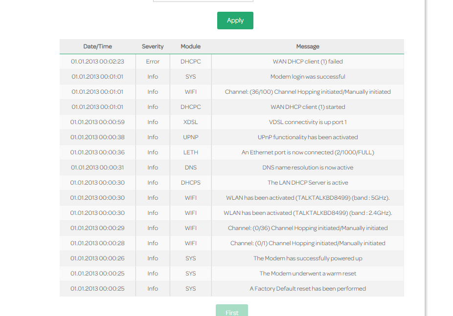

Back again @Anonymous
   as I was trying to upload the screen shot of the logs connecting to my very weak mobile Hotspot, the broadband internet connection restored , anyway here is the screen shot after the factory reset ... you will see we had no Public IP
here is a screen shot of the log after the internet access came back !    strange ( but working) Public IP 2.97.197.229

I have completed a "factory reset" but still no Internet access
still the same error .. I will try and upload a screen shot of the router log
many thanks
John

Let me try and explain further, I have added further information from the router/hub, that shows my xDSL line is connected,
but I have not been allocated a Public IP, repeated "DHCPC WAN DHCP client (1) failed" errors
From my first POST: 07.06.2022 03:30:46 Error DHCPC WAN DHCP client (1) failed
This issue started at 03:30 this morning Tuesday 7/6/2022, is there a know network issue?
Can the "DHCPC WAN DHCP client" issue be caused by the router ?
Router Log Info Below
