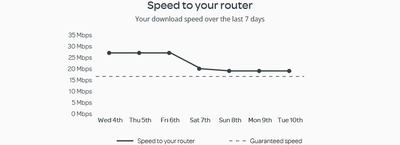

Hi,
Over the weekend I received a new Sagecome router to replace my old one. Straight off the bat I noticed lower speeds but just put it down to bedding in issues, so packaged my older router to return.
The speed is a good 6-10 Mbps slower than previously (upload has increased however from 1.8 to 4-5mbps)
Today the speeds haven't increased so I tried to see if it was my internal hardware, I connected my laptop directly up to the router with the included ethernet cable ( and later tried with another as a good measure) nothing else attached with wifi disabled, so I can be doubly sure only one device was connected, and below are the results.
And below are the just an example of the older speeds I had to hand
Any help would be greatly appreciated

Also, could it be any settings on the router itself? As mentioned previously up until installing the new router, we had faster download but had lower upload (it's like the router is somehow allowing a higher upload and throttling the download to compensate)
