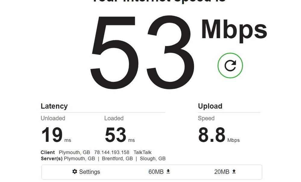

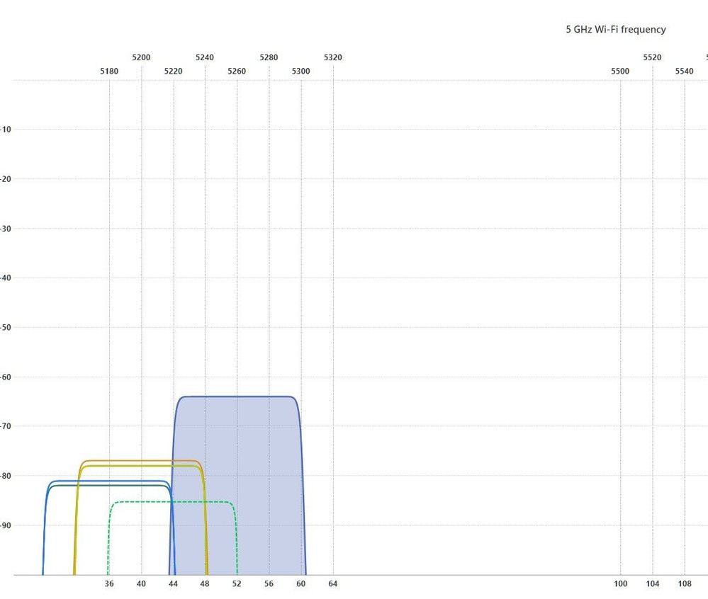

Hmm, but then... the loaded latency seems to mirror the lumpiness in loading random pages. Ran the wifi analyser at the same time, and that seems all stable, no change from previous, to my eyes.

So far, so good... and here's this evening's crop:wifi1.jpgwifi2.jpgwifi3.jpgwifi4.jpg
