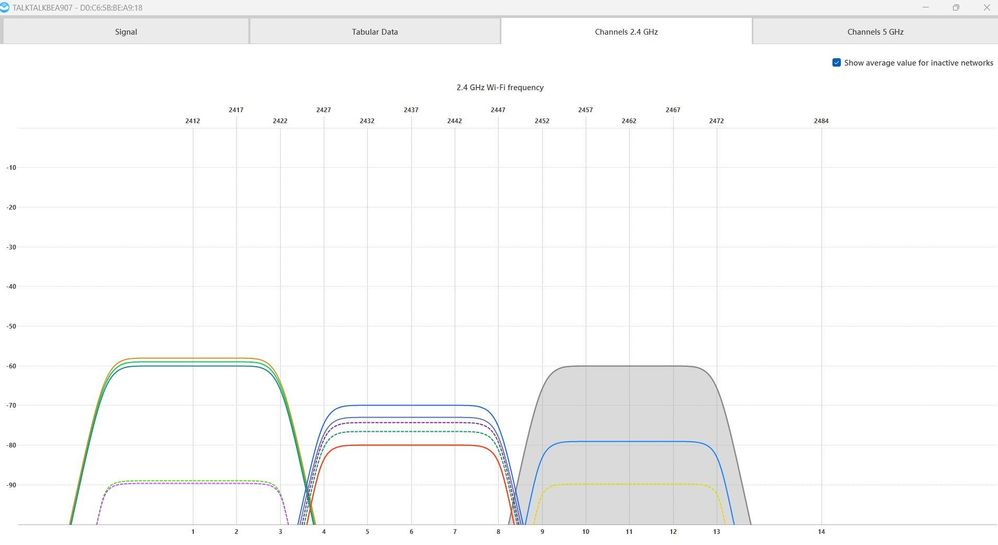

on 30-09-2022 10:04 PM
Message 25 of 38
Oops, thanks @ferguson for pointing out my typo!
The 5GHz channel I meant you to use was 52, sorry about that.
Keith

29-09-2022 09:31 AM - edited 30-09-2022 10:04 PM
Message 28 of 38
They are fine thank-you.
A couple of recommendations:-
- Please move the 2.4GHz band to channel 11. You can only use channels 1, 6 or 11 in this band as they are classed as the only non-overlapping channels.
- You can try moving the 5GHz band to channel 52. When you do so, you will have to wait at least 60 seconds before the network will be available again. Then you must check that all of your 5GHz devices can still use this band. Whilst totally permitted to use channels 52 - 140, not all Wi-Fi network adapters have the additional circuitry in them to use these channels.
Keith

on 28-09-2022 08:45 PM
Message 30 of 38
Show option menu
- Mark as New
- Bookmark
- Subscribe
- Mute
- Subscribe to RSS Feed
- Highlight
on 27-09-2022 10:38 AM
Message 31 of 38
I will PM you a link for a guide of mine on Wi-Fi interference & initially look at the section called "Are you suffering from interference – prove it first". This section includes full details of Wi-Fi analysers that I recommend for Windows, Windows phone, Android and Apple operating systems. However, I have no way of testing the Apple product. Do not worry about interpreting the results, I will do that for you.
Please post the screenshots that I have requested in my guide (no photos please they can be difficult to read as text can get out of focus when zoomed in), from the analyser you are using (also in my attached guide). Please ensure that the analyser window is maximised (if Windows) before taking the screenshots & upload them via the "Insert Photos" button (in a mobile browser it's the picture icon) on the post editor's toolbar with the Size parameter set to Large. If they are too small, I will not be able to read them & although I can enlarge them, this puts the text out of focus. If you prefer PM them to me. If you do PM me, then please add a link in there to this thread, so that I can find it easily.
Keith

on 27-09-2022 10:24 AM
Message 33 of 38
Slow speed, intermittent dropouts, breaks in the signal, no signal on some or all devices or no internet access might be caused by Wi-Fi interference from other local networks, which can also lead to a permanent reduction in speed. No ISP can be responsible for your local environment, this is mainly a byproduct of the popularity of Wi-Fi.
Generally speaking, the 2.4GHz band suffers much more from interference than the 5GHz band, but the 2.4GHz one can sometimes have a better range, but this all depends on your local area.
If you would like me to help you, please can you specify the make/model of TalkTalk router that you are using?
Keith
