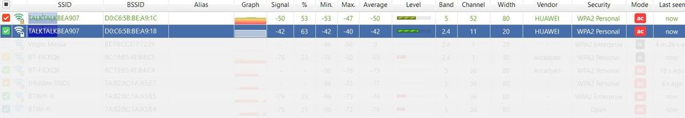

I am not sure I have seen such an app. There is another one I was going to mention from Nirsoft called WiFiInfoView, this provides all sorts of details about your connection for that band (highlighted in green). You can then click on the other band and press F2 or right-click & select Connect Selected Access Point. It will then try & do that for you & removes any chance of Windows or the network adapter getting it wrong. You can download this from:-
https://www.nirsoft.net/utils/wifi_information_view.html
Unzip it & run the exe from there, no need to install.
Keith

on 04-10-2022 10:45 AM
Message 11 of 38
I think this accounts for your speed test results. You are connected to the 2.4Ghz band using 802.11n (Wi-Fi 4) at a link speed between it and the router of 65Mbps. Your card is capable of working in the 5GHz band at the faster 802.11ac (Wi-Fi 5) at a link speed of up to 433Mbps.
So why aren't you connecting at that speed?
The initial decision is down to Windows/the network adapter as to which band it connects to. This should be based on the band with the best signal quality (mixture of signal strength & the amount of interference). The signal strength of your 2.4GHz band is a bit higher than the 5GHz one, once connected to the router, if band steering is enabled in there, it should then automatically try & move you over to the 5GHz band after a short while.
I would check the network adapter's properties to see if there is a Preferred Band option. To do this go into Device Manager expand Network adapters, right-click your network adapter & select Properties. Click on the Advanced tab & look in there. If you have such an option set it to 5GHz first.
I don't think we have investigated the physical location of your router, to see if signal strength can be improved a bit.

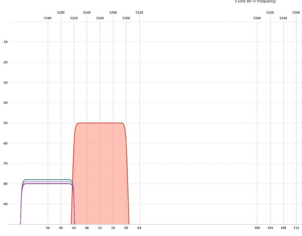

on 02-10-2022 02:16 PM
Message 14 of 38
Hmm, but then... the loaded latency seems to mirror the lumpiness in loading random pages. Ran the wifi analyser at the same time, and that seems all stable, no change from previous, to my eyes.

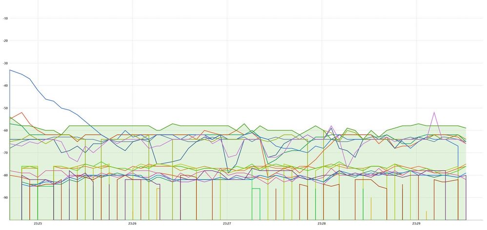

01-10-2022 11:31 PM - edited 01-10-2022 11:32 PM
Message 18 of 38
So far, so good... and here's this evening's crop:

To work out exactly what is right also I will need to know what Wi-Fi network adapter you have in your PC. What happened at 13:17 in your signal strength/time graph? You might need to look at the Windows Power Management settings:-
Where USB or PCIe-connected WiFi adapters are concerned, power management is best disabled if running in Windows to keep a reliable Wi-Fi connection working at full speed. Once having made the changes outlined below, it is probably best to restart the PC.
To do this in Windows 10 or 11, open Device Manager and expand Network adapters. Then right-click your WiFi card & select Properties. Next, click on the Power Management tab and untick Allow the computer to turn off this device to save power. If the adapter is connected via USB, then expand the USB section in Device Manager and the same option can be found in the Power Management tab in most Root Hubs and USB Controllers. Untick it in there as well.
Keith
