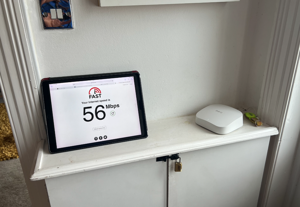

Thank you everybody for all your help. I still do not have speeds over 70 MB per second on the Wi-Fi I have now unplugged all connected devices smart plugs Amazon fire stick six Septra and have removed them from the Eero app. I have changed the password on the router so nothing can connect other than my Macbook. The macbook is wired into the second Eero and the speeds now between the two mesh routers (5M apart) are around 70Mbps. I'm not expecting to get 500Mbps on the wifi just because I have it into the ONT box, but surely if i have one device connected on Wifi a few meters away then I would expect much more than this?
A few pictures for reference, if i unplug everything and add single items to the wifi and have them next to the router, you will see that laptop/phone/ipad and TV are all supper close to the main router and even when they are the only device connected i'm still not getting any good speeds. I would love to know what other people are getting with a 500mbps ONT -> Eero.6pro -> wifi -> laptop connection this close to the router. I image at least 300-400Mbps given the Eero is supposed to support 1Gbps and i can see TXRates of 700-800Mbps sec on the macbook.
For the support guys, these pictures also highlight why I'm pretty sure adding another router to the system will not fix my issues.
Thank sin advance for any help

I think that your 2.4GHz band is probably suffering from WiFi interference.
Slow speed, intermittent dropouts, breaks in the signal or no signal on some or all devices or no internet access might be caused by Wi-Fi interference from other local networks, which can also lead to a permanent reduction in speed. No ISP can be responsible for your local environment, this is mainly a byproduct of the popularity of Wi-Fi.
Generally speaking, the 2.4GHz band suffers a lot more from interference than the much faster 5GHz band, but the 2.4GHz one can sometimes have a better range, but this all depends on your local area.
In other words, I try to help you optimise your Wi-Fi connection. The next stage involves sending out a guide to you to help you get me some important diagnostic results so that I can analyse them for you and recommend changes to your router configuration to solve them.
I only send this out to people who request it.
Whilst the eero is supposed to manage Wi-Fi interference, if this is very bad, particularly in the 2.4GHz band, then it cannot do anything about it, no router can. The same goes for any router at that point. Other things that may then need to be investigated are its location within your property and the WiFi bands that you use. It is possible that you may also need to purchase additional eero nodes as it is supposed to operate as part of a mesh system. I can help with any of this. However, I would suggest that you follow my help to find out what the root cause of the problem is, before throwing money at it.
