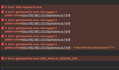

Finally got it working - using Firefox! Firefox works perfectly, I was able to save all my reserved IP's and port forwarding.
When using Chrome or Safari, I seem to get the same issues which seem to be related to authentication:
Chrome:
Safari:
Anyway mines all working, might help someone else that finds this thread, try Firefox 🙂
