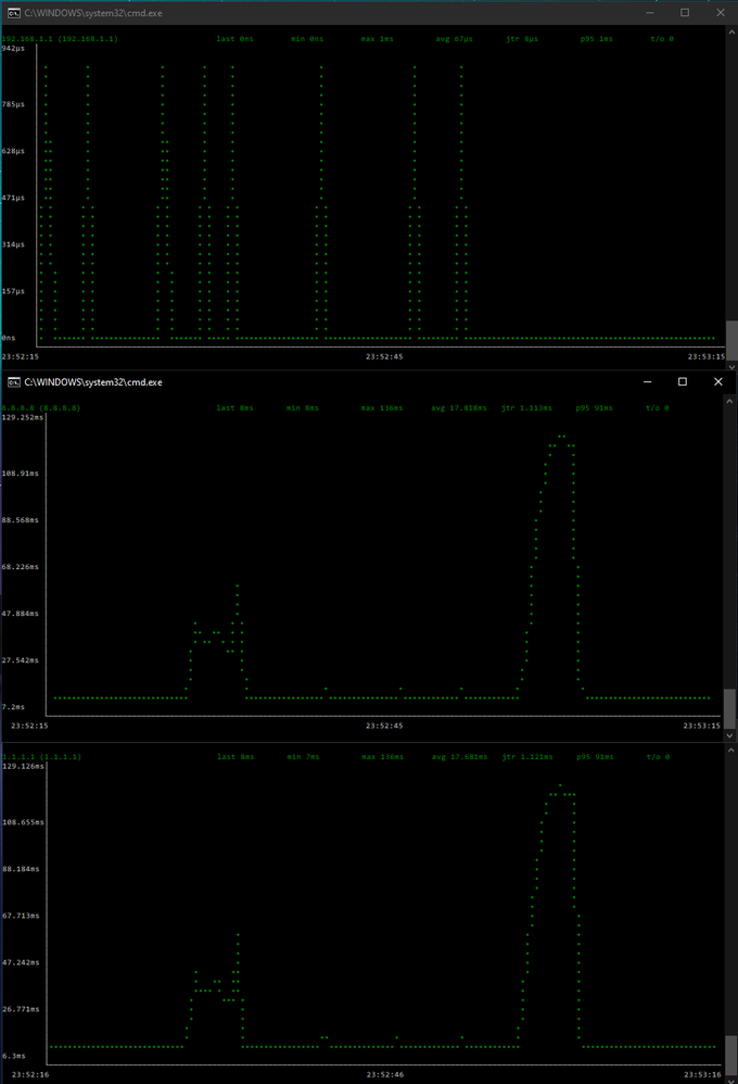

For months we have been experiencing random disconnects when gaming. It does not matter the game, nor the PC, they happen seemingly at random and last 4 to 5 seconds each time, then service resumes as normal. This is increasingly frustrating as it has not improved and continues to happen quite frequently. This wouldn't be a problem for e.g. watching TV streaming services that maintain a buffer of upcoming video, but for real time gaming this completely ruins any game it happens during.
To investigate whether this was the fault of my PC, my router, or of somewhere in the TalkTalk connection to us, I ran continual pings on two PCs, each pinging both the router and a Google DNS server. This is in the attached image, for clearer understanding. Both of these PCs are hardwired with ethernet to the router.
You can clearly see on the ping graphs where I have marked with red lines, this is where the game disconnection was experienced. The graphs are stretched differently as one PC had them full-screened, the other had them beside a game window, but both are the same 1 minute duration. During this time, neither PC experienced any noticeable increase in ping to the router itself, suggesting the router was keeping up just fine and not at fault. However, during this time both PCs experienced a large increasing ping spike to the Google DNS server 8.8.8.8. After a few seconds (always somewhere between 4 and 5 seconds) that ping spike dropped back to normal, at the same time the game manages to reconnect. I am unsure if this ping spike increasing over time rather than being a solid block of disconnect was because of the `gping` tool I used doing some short term averaging of ping, or because it actually was slowly increasing in latency, but regardless the experience in games is a hard disconnect every time.
From this experimentation I'm relatively confident it isn't a fault on our end, but if anyone has any suggestions as to what might be causing this (or if TalkTalk could take a look into this as it has been happening for months now) I would be very grateful!

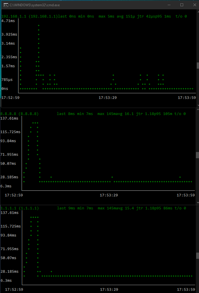

Have just had it happen at 11:53pm GMT while pinging the router, AND 1.1.1.1, AND 8.8.8.8, with DNS settings still set to 8.8.8.8.
BOTH 1.1.1.1 and 8.8.8.8 experienced the huge spike, and again the game disconnected for 5 seconds, and the router ping experienced no dip. Please see attached screenshot (router, 8.8.8.8, 1.1.1.1 top to bottom, as shown in the top left of each CMD window)
Will changing my DNS settings to 1.1.1.1 and observing latency during another disconnect still be beneficial given both DNS IPs got the spike?
