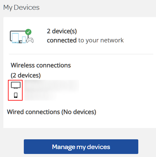

KeithFrench
Message 5 of 127
Hi @durdle
Hopefully, this will help. The Icon can be seen against the device list in both My Devices:-
My DevicesMy Devices
as well as the Advanced Settings device listing:-
Advanced settings device listingAdvanced settings device listing
Then clicking on the device will take you to Device Info. This will allow a friendly name to be set to what you want, as well as the icon to be changed to one of the provided ones. This is where you can't use "Camera" icon, due to the bug I mentioned:-
Device InfoDevice Info
However, if a friendly name is set above and in WiFi Mesh > Devices a different name is set for the same device, the latter one will be the one that is always used.

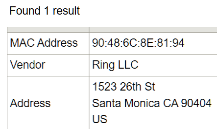

Hi @durdle
It is easy for me, but I appreciate it might not be for you. A MAC address is made up of 6 bytes of data, e.g. 90:48:6C:8E:81:94.
The first 3 bytes 90:48:6C is what is called the vendor code or OUI (Organisational Unique IdentifierI). This identifies the manufacturer of the WiFi adapter. OK, I know that a vendor is not always the same company as the manufacturer, but that is what they called it when the standards were drawn up years ago.
The second part (8E:81:94) uniquely identifies the WiFi adapter (like a serial number).
What you have to do is to visit this site, paste in the full MAC address and click Lookup Mac address:-
https://aruljohn.com/mac.pl
The result shows that the vendor is Ring LLC:-
OUI LookupOUI Lookup
The next thing is to look in the Ring app to find which Ring device has this MAC address. It may be listed as the MAC,  Physical or Hardware address. Then that one is solved & onto the next.
You can't remove an address, but old ones will "time-out" after a while.
Keith

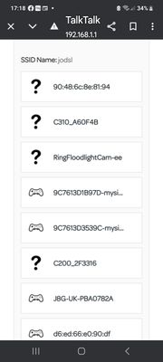

@KeithFrench , I'm still feeling my way here, but how did you link those three to Ring devices? They would have to be the three chimes in my system, and I can probably identify each one by referencing the nearest booster etc, but the three screenshots here, taken on my 14" tablet,  are rather more inclusive than my previous set, taken on my much smaller phone.  I can see how to rename devices and, with regard to the controllers, I would like to be able to remove the four of them, but I can't see a remove button anywhere. They will undoubtedly be for my 14 year old grandson's games consoles,  and I would prefer to be able to confine him to the jodsl-GUEST network; I'm not entirely sure how though.  My devices 05/10/24My devices 05/10/24Channel populations 05/10/24Channel populations 05/10/24Connected devices 05/10/24Connected devices 05/10/24

KeithFrench
Message 15 of 127
Hi @durdle
Here you go:-
90:48:6C:8E:81:94 - Ring LLC
9C:76:13:D1:B9:7D - Ring LLC
9C:76:13:D3:53:9C - Ring LLC
D6:ED:66:E0:90:DF - No matches - is this correct?
These two are not MAC addresses:-
C310_A60F4B
C200_2F3316
Keith

Message 16 of 127
I should be able to identify the make of the WiFi adapter in them, which is not always the same as the manufacturer of the device. I'll see what I can come up with over the weekend.
The ? is because the router could not identify the device type, e.g. PC, Laptop, Phone, Tablet etc. Don't use the Camera one though, it has a bug if you do. I have found that with V202 on the router, its Device listing is often not up to date. The Wi-Mesh Devices sub-tab is much more accurate. When you know what device is what, use the Rename facility to call it what you want. This will override any names that you may have set in the router's Advanced Settings device list.

Message 17 of 127
Thanks. Couldn't have managed without all the advice though. Meanwhile, I've noticed that the router dashboard can identify a few devices like my Ring cameras, my phone and my tablet, but not most of them. Given that I can't expect the various MAC addresses to apply to the same device two days running, is there any way I can identify which of the entries with question marks at any one time belongs to which device, allowing me to rename them in the dashboard? Digging around this deep in the dashboard is all rather
new to me.
johno
