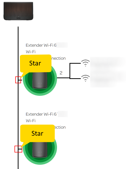

@KeithFrench , the doorbell battery is around 55%, according to the app. With only booster 2 powered up and much nearer the bell (on an extension lead) than the router I took the bell down down and briefly disabled it, whereupon the rssi value shown in the app shot up from -70 to -45. This is all a bit like herding mice, and it seems to me that using the app is a hopelessly inaccurate way of checking signal strengths, so, for the time being, I'll try for the star topology before I take much notice of anything else.
johno
Message 23 of 127
My mistake,  @KeithFrench , I thought I had to set up a Star topology first, but I see what you're saying now. I'm not optimistic about any of this, though,  because power points in my house are few and far between, with none in the the corner part of the house where the doorbell is located. I'll give it a go.

It does indeed and you want Star topology, which is why I gave you my recommendation in my previous post to try & achieve that.

Thanks, @KeithFrench, but my attachment above shows a tree topology, does it not? Should I not try for star one?

This is my recommendation:-
Each 266 needs to be in a location that has an excellent or good signal reception from the router. To test this connection, first turn off all other F266s and try moving the one F266 to a suitable location to achieve an excellent or good signal strength from the router (gateway). Then turn that one off & repeat the sequence for all other F266s, one at a time. Next, each F266 needs to be far enough apart from the other F266s, to ensure that the signal an F266 receives from the router is higher than the one it receives from a nearby F266.
Similar to a router, they need to be out in the open, not shut in a cupboard. Neither must it be near any electrical equipment or large expanses of metal, fish tanks or water. Wi-Fi signals do not travel well through any type of glass.

@KeithFrench, I connected the new booster using WPS on the router,  but I seem to have ended up with a Tree configuration.  How do I unravel this, please? Should I delete them both and start again? If so, how do I do that, please? I've never previously changed anything this deep in Not what I was expecting.Not what I was expecting.router settings.

There is no need to power the first 266 off before connecting the second via WPS. Yes, a Star is what you want, that way, any device connected to either 266, has only got to go through the router & out to the internet. A Tree would force devices connected to the furthest 266, to first go through the other 266, before they can get to the router & the internet.

My second F266 has been delivered. Am I right in thinking that to create a Star configuration, I don't need to have my first one powered off when I set up the new one via WPS, because I'll be linking it to the router?

There are some technical challenges when using two or more of these. When you are using more than one FAST266, you need to pay attention to the network topology that has been adopted in the Wi-Fi Mesh management’s Overview page:-
Dashboard > See Wi-Fi Settings > Manage Advanced Settings > Wi-Fi 2.4Ghz gear icon > Wi-Fi Mesh > Overview
The fastest connection for a device connected to a 266, will be if that 266 is connected directly to the gateway node in a Star topology (see diagram later).
However, that 266 might be connected in a Tree topology to another 266 before routing to the gateway node (router). This will represent a slower path for any device connected to that 266, as it first has to go through the other 266 to reach the router.
These are examples of Star & Tree topologies:-
Star/Tree TopologiesStar/Tree Topologies
This is an all Star topology, which is what you want to aim for:-
All star topologyAll star topology
The gateway & extender nodes compute the current network topology & are dependent on their location & signal strength of the backhaul network. The only real way to change this is to pay close attention to the location of all these mesh nodes.
Each 266 needs to be in a location that has an excellent or good signal reception from the router. To test this connection, first turn off all other F266s and try moving the one F266 to a good position as far as signal strength is concerned. Then turn that one off & repeat the sequence for all other F266s, one at a time. Next, each F266 needs to be far enough apart from the other F266s, to ensure that the signal an F266 receives from the router is higher than the one it receives from a nearby F266.
