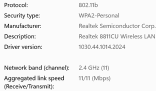

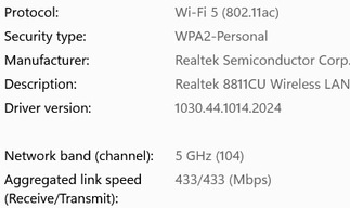

I can get mine to connect using 802.11b but the speeds drop to 4.46 Mbps from 153.56 Mbps i am sat 6 feet from the router.

I have just forced the wireless adapter in my PC to use only 802.11b and it refused to connect to my eero 6. There is in my opinion no point in raising this as a bug with eero support, as it is so insecure.

Message 3 of 27
These are just WiFi diagnostic applications, which I did monitor my eero 6.
Keith

I need to change a statement I made previously. Both the eero 6 & eero Pro 6 DO support 802.11b, some diagnostic software I was using yesterday must have a bug in it. One application showed it did not support 802.11b and another one said it did.
So if you want to revisit this, I will try & help you. However, I still think that you would be much better off replacing that TV.
